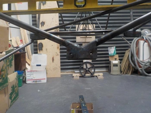

Brief Description:  Vee strut

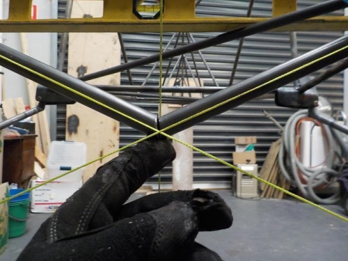

Using a plumb bob and string lines between the outer vee strut attach points and the axle tabs, shows me where to cut the tubes to be exactly centred.

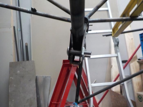

.032" steel is cut and drilled per plans and then a scrap 5/8" spacer sets the correct width to weld it in place.
