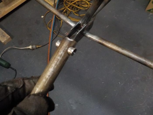

This is how I set the 7/8" long spacers onto the gear legs.

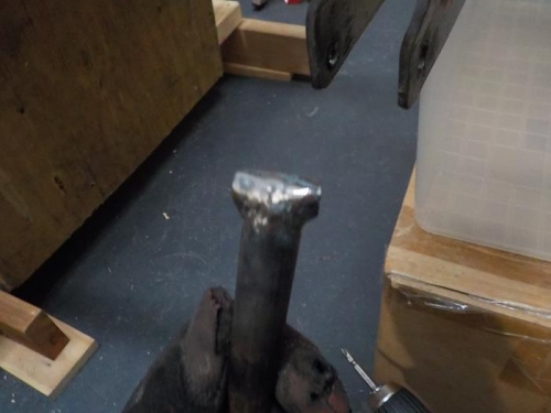

Drilled a 3/8" hole through the centre of the gear leg then checked the spacer for fit which has already been drilled out to 1/4".
Cut the top of the gear leg off to then heat and round over the steel.

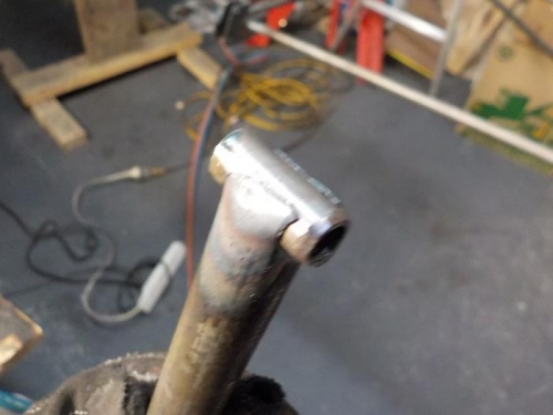

Weld the spacer in place.
