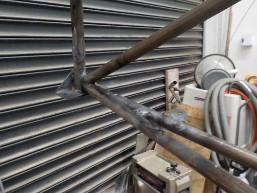

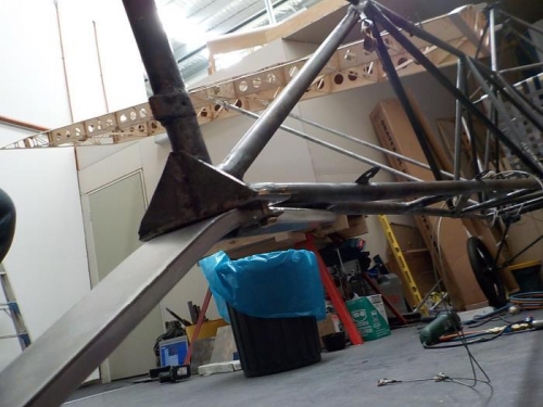

Brief Description:  Tail wheel attachments
Welded the tail spring mount to the bottom of the tail post and then a 5/8" square tube between the lower longerons where the forward part of tail spring will be bolted.
Can also see the tabs welded tothe longerons for the lower HS bracing wires to attach to.
The 4130 strap holds the rear pivot point in place.
Strap
Strap
