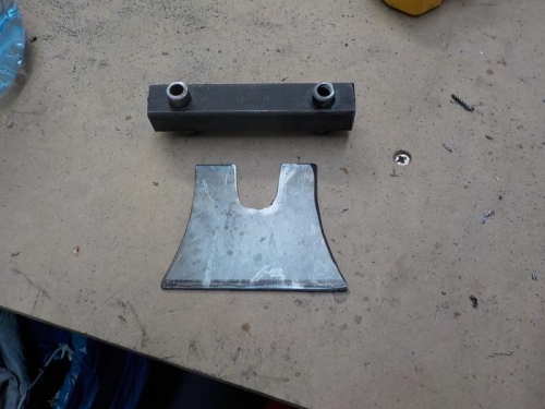

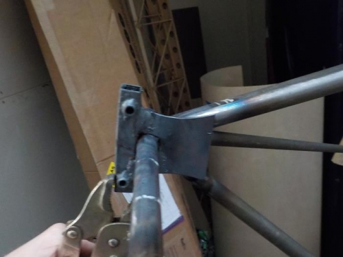

The wing mount fittings have been pretty straight forward. Built to plans and made sure the 3/8" tubing is a perfect fit for each attachment at the wing root after being welded into the square tube. Easier to do now than when trying to mount the actual wings.
I have loosely attached the mounts to the fuselage allowing them to rotate freely and will weld them permanently in place when attaching the wings proper.
