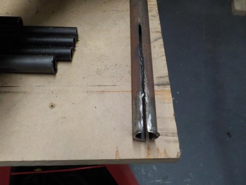

Made some finger patches for the cabane clusters out of 3/4" x .035" tube. Cut in half lengthways and then cut off the tube. The 3/4" fits nicely over the 5/8" fuselage tubes.

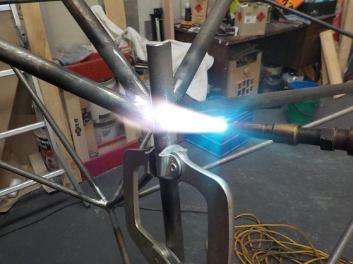

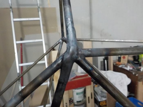

Clamped and heated before bending with a hammer and then welded
3/4" x .035"
Heated
Welded
