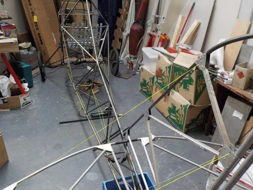

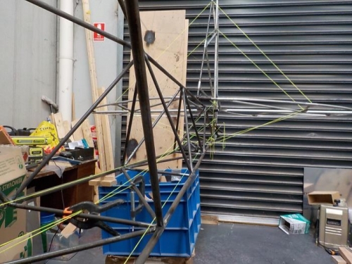

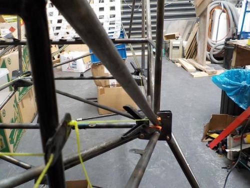

Running string lines from the controls to the rudder and elevator horns shows me where I need to attach cable fairlead points. I also put string on the tail feathers. There really is quite a few feet of cable required.
The last pic shows the LE sitting on the mains. The shock struts are temporary as I will be building suspension in the following weeks....and yes I did sit in it, operate the control column and rudder pedals and get a feel for stance. Feels like another milestone.
From rudder
From rudder
Potential attach points
