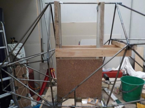

Finishing off the front section, the forward jig had to be removed to allow the remaining diagonals to be cut and tacked in. Lots of delicate grinding with the flap disc to have all the clusters meet perfectly.

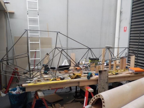

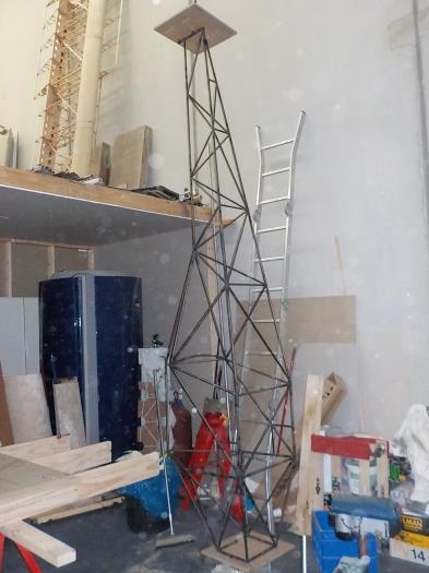

The last of the jigs have been removed and the big bench disassembled to make way for the very simple rotating jig that will hold the fuselage front and back to make welding easier. Plumber's clamps hold particle board mounts to the front and rear and I can now stand the fuselage in the corner whilst cleaning of the garage begins.
Making room
Making room
Jigs gone

Standing
Standing
