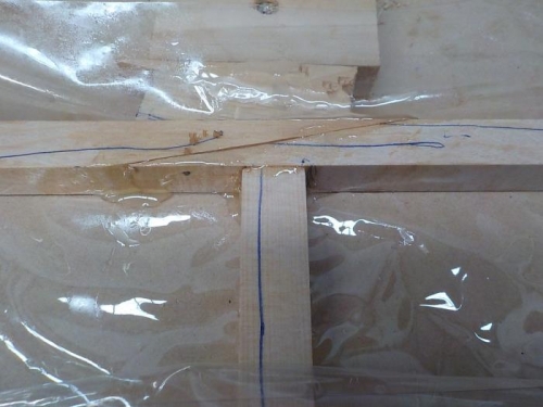

Selecting timber for the rear spar, lower cap (3/4" x 5/8") I realized I had cut a few feet off the longest piece available for the job. In order to get back to the full length it was necessary to create a scarf joint at a 10 degree angle.
The jig is really simple. Cut a scrap piece of 140mm x 45mm timber with the mitre saw set at at 10 degrees. Return the mitre saw angel back to 0 degrees and clamp the scrap jig. Place the 3/4" x 5/8" cap against the jig, hold and cut. Repeat on the other piece and they join together perfectly straight.
The scarf must be supported so I have made it to join over a 3/4" x 3/4" vertical riser. Before applying epoxy resin to both surfaces a small nail was driven through then removed temporarily. With epoxy coating the surfaces, the nail was the tapped in to stop the joint sliding apart as clamping pressure was applied.
Jig
Jig
Epoxied, nailed, clamped
