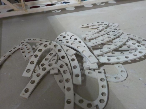

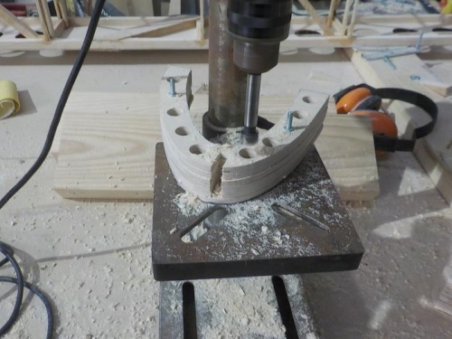

Lightening holes
Holding 5 ribs together with 2 x 3/6" bolts and nuts, a rough cut rib is used as a base.
Easy going with the forsner bit and eventually lightening holes have been added to all.
Couldn't resist balancing the nose ribs on the main spar.
The wing is not resting on the floor but is held up by the main spar sitting on top of the slightly overhanging stacks of water bottles.
Forsner drill
Lightened
Wing
