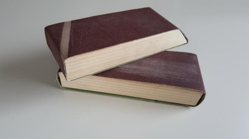

Got onto a great idea for sanding blocks using off the shelf sanding belts.
Here's a link.
http://www.instructables.com/id/Simple-Belt-Sander-Blocks/

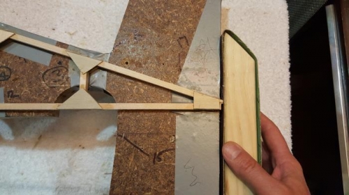

Made mine even simpler by cutting and rounding 75mm x 35mm pine to the exact size of a snug fitting belt (457mm).

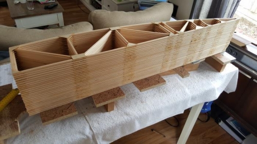

Ribs placed back in the jig for the final time whilst the trailing edges are all sanded to the exact same length then stacked 26 high.
