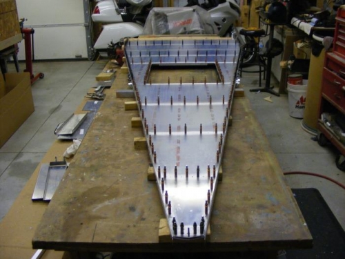

Deburr complete on all detai;ls. Joggles added to fwd Z stringers
Cortec added to faying surfaces of all details and cleco'd back together.

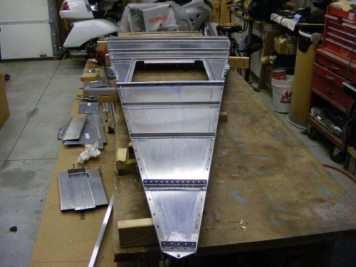

after everything is secure, We flipped the skin over so we could rivet it right side up
all details back in place
All clecos installed

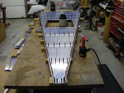

Ready to rivet
Ready to rivet
