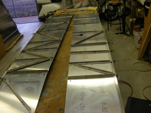

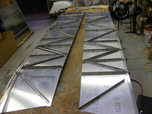

I fitted the diagonal stiffeners the same way I did the verticals, by aligning the marked rivet line with the pre-drilled holes in the aft side skins
starting to fit diagonals
most diagonals cut to fit

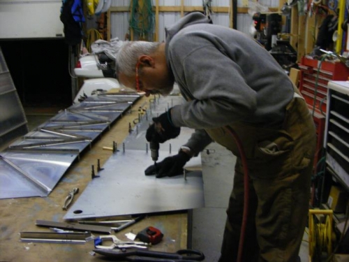

Starting to drill
