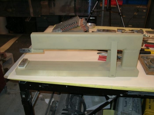

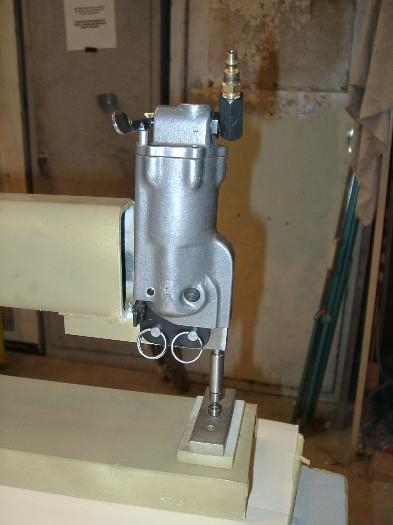

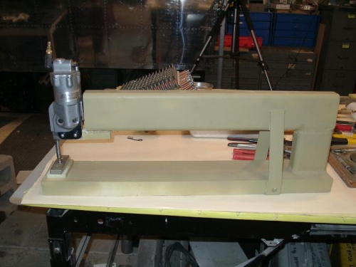

Brief Description:  Designed and constructed Pneumatic "C'" press.
Designed and constructed a "C" Press to utilize the Avery Pneumatic rivet squeezer. Had Rice Machine Tools make an attachment bar using a standard yoke as a template then welded it to the assembly. Modified the actuator bu flipping it end for end and using a spacer to align the arm. Swaps back for normal operation. Works fine and can get to the center of a 48" wide sheet! Much faster dimpling skins!
