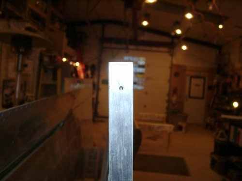

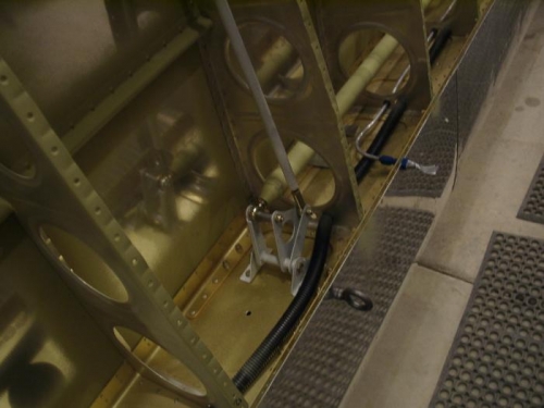

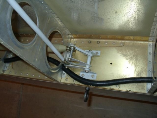

Brief Description:  Finished assembly of Aileron Controls
Got the pushtubes and Bellcrank assemblies fabricated and installed in both wings. I have the clearance problems with the aft end of the small pushtubes as discussed in several blogs. I'll disassemble them and file the holes in the rear spar to clear the maximum deflection movements.
Left Wing Aileron Controls
Right Wing Aileron Controls
Alignment is dead on!
