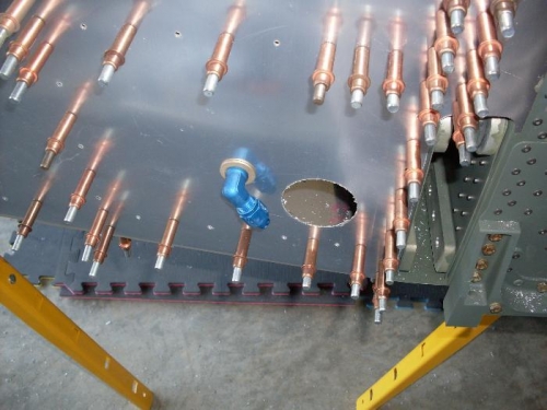

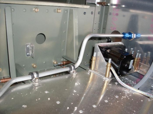

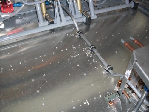

Completed fuselage fuel system as follows:
1. Replaced bulkhead fitting with AN833-6D to allow for more clearance when the wings are fitted. A hose will be fabricated to transition from this fitting to the wing system.
2. Fabricated a 3/8" fuel line from 5052-0 tubing and flare fittings for LH wing to fuel valve run.. Drilled holes in floor for clamps and inserted rivnuts.
3. Drilled holes in floor for line running from the fuel valve to the firewall. Inserted rivnuts.
4. Removed all tubing and set aside until final assembly.
