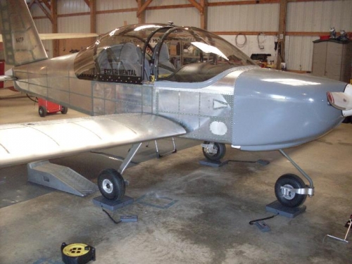

Weighed the aircraft as follows:
1. Jacked the aircraft under each main gear attach and placed scales centered under the main wheels. Hangar doors were closed and no air was circulating.
2. Jacked nose gear and placed a scale under the nose gear.

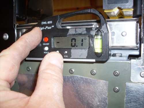

3. Checked the aircraft logitudinal level on the forward longeron.

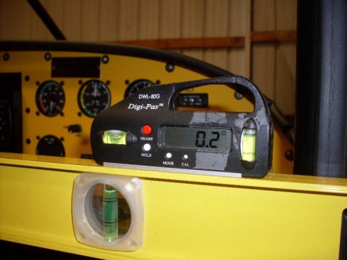

4. Checked the aircraft lateral level across the canopy tracks.
5. Recorded readings on each scale. Applied correction factors calculated during calibration procedure and entered the following weights on the W&B worksheet:
LH Main Wheel: 329 lbs
RH Main Wheel: 331 lbs
Nose Wheel: 162 lbs
Total Weight 822 lbs
CG 86.1" aft of datum
Note: The above calculations include unusable fuel, full engine coolant, full engine oil, full brake fluid, and baggage compartment bulkhead.
6. Rolled aircraft off scales.
