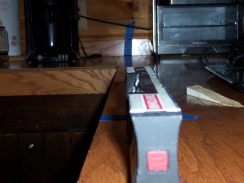

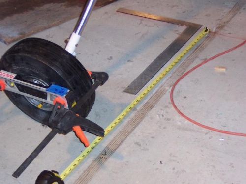

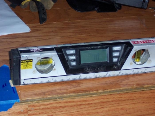

Arion manual is not clear at all. Had no confidence in their "measurements" to compute the1 degree toe in. Reference point is to center of tire and they have you putting a laser level on the brake caliper.. may be right but does not make any sense and have no confidence it.
Decided to take my laser level and figure out the displacement, out 5', of 1 degree toe in. That equates to 2 5/8". Plotted that on floor off of center line of fuselage
1 degree
1 degree
at 5 feet - 2 5/8
at 5 feet - 2 5/8"
center line to line on dot of laser level
