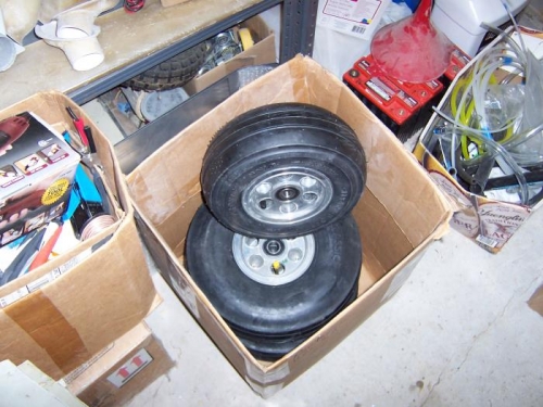

mount all 3 tires
Torqued AN4 cap head bolts on split wheels to 60 lbs/ft - standard chart torque as I found no reference in the Arion manuals anywhere.
