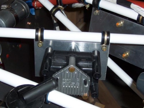

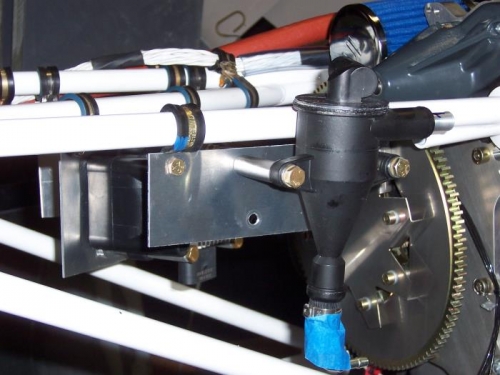

move air/oil sep. and R coil
Started to route oil breather and return lines and was not happy with the geometry. Decided to reposition the R coil inboard on the enigne mount and move the air/oil separator to the right mount ube and forward. Better angles for the hoses
R coil moved inboard
air/oil separator moved up and forward
