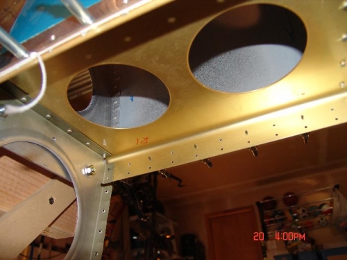

Brief Description:  Begin riveting of the leading edge
Rivet 1st 3 ribs from the outboard end by squeezing as many as possible to reach. Had to leave the top and bottom rivets on the outboard and 3rd rib -- they outboard ribs were blocked by the temporary bracket holding the rib to the h-frame. The inboard #3 rib is near a small hole and hard to reach.
