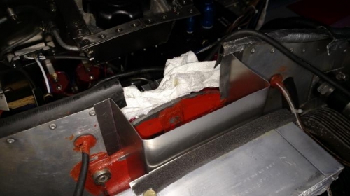

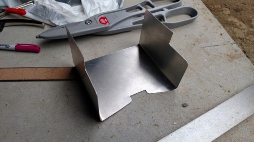

- Started making then bends in the new baffle
- The baffle is horizontal across the top, but needs to be cut at an angle to follow the slope of the top cowl.

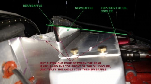

- When test fitting the cowl I saw that the cowl would be touching the top-front of the cooler, So I used a straight edge and drew a line from the existing rear baffle (metal, not the rubber) to the top-front of the cooler (see photo #3 below). I drew that line on the new baffle and cut there. IT WORKED, so that's my recommendation.
Made the first bends on the new baffle
Test fitting and trimming in place
How I got the angle to cut the new baffle
