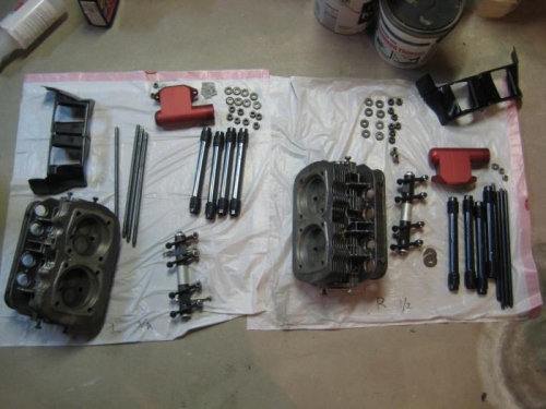

3. Cleaned more of the miscellaneous parts in the first photo, below.

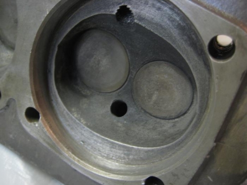

4. Cleaned the carbon off the heads. There was build up where the new head gasket will go. To get a good seat I had to clean it up. I used a dental pick, then sand paper, then Scotch Brite pads.

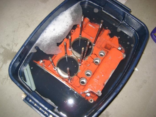

5. Began to soak 1/2 of the case in TSP and water.
6. Cleaned up the crank and the cam shaft with degreaser.
7. Replaced the nuts on the the rocker arms (the stock ones start to get rounded over with all the valve adjusting, so I thought this a good time to replace them for $5.00).
