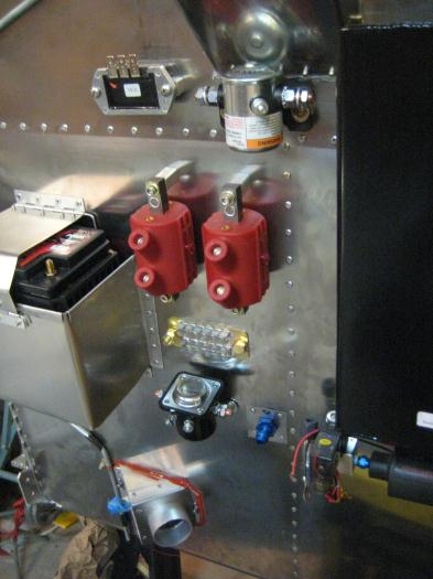

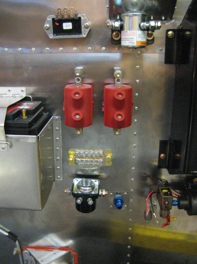

I really suck at figuring electronics. I spent a bunch of time reviewing my draft wiring diagram and figuring which wires would go where, so I could make sure that even with fat, heavy wires I could create a fairly neat pathway between points. But I'm also running out of firewall real estate, especially with the big honkin' smoke oil tank!
So I located the master relay just under the fuel filler (silver cylinder at top of pictures), and the starter relay below the ground bus (black cylinder at bottom of pictures). In the Sport Air WorkshopI went to last year they cautioned against putting these two too close together, as a heavy fat wire would have a hard time running between them. The layout here, when you trace the wires from the battery, to the master relay, to the starter relay, actually lays out very linearly and neatly.
I've asked local Sonex builders and the SonexTalk group, for help on my wiring diagram. I need all the help I can get!
Head-on view. Master relay at top right; starter relay at bottom left.
From another angle. Damn that smoke oil tank takes up a lot of real estate!
