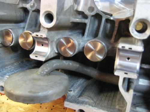

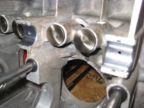

Brief Description:  Assemble case & bearings
Photos 1 & 2: lifters greased and installed. 3 of the lifter guides had a little "grab" to them, so per the installation instructions I lightly sanded their insides (I used a Scotch Brite pad), after which I cleaned them out. Worked great.
Photo 3: One half of the center crank shaft bearing installed and greased.
Lifters and cam bearings in place.
Another shot of the bearings and lifters.
Center crank shaft bearing in place and greased.
