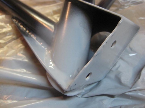

- Deburred and sanded the holes and other areas of the 4 engine mount points, that were reshaped over the last few days.
- All the drilling, filing and sanding left bare metal in places, so I sprayed primer on those areas. I'll add gloss black paint tomorrow.

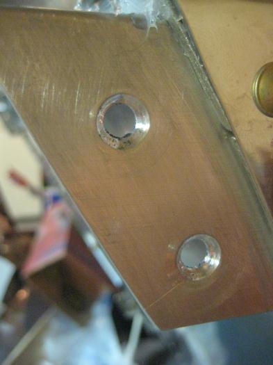

- Countersunk the holes in the fuselage engine mount brackets. The plans don't call out for countersinking, but in every other photo I've seen on other builders' web pages, they are countersunk. It only makes sense, since the fiberglass cowl needs to sit here.
Primer paint to cover areas where paint was worn off.

Countersunk holes in engine mount brackets.
