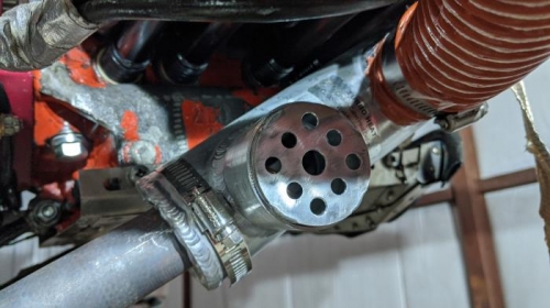

The removeable restrictor at the "out" end.

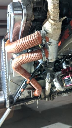

2" scat tubing in place. Supply must be the one furthest from the firewall.

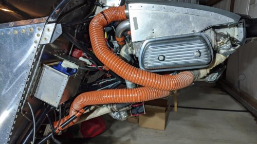

Viewed from the front.
