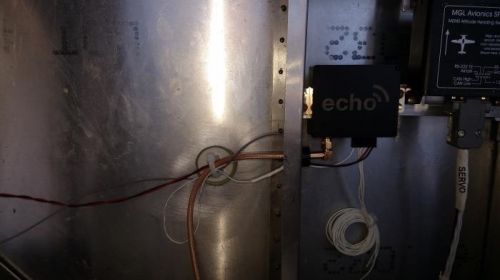

Brief Description:  ADSB Installation
Ran the power and ground wires from the echoUAT box, to the panel and the ground block. Made the crimp connection at the "ADSB" switch on the panel. Added a Click-Bond so I would secure the wires and antenna with a zip tie near the echoUAT.
2 hours of work.
On 11/24 I configured everything with a mobile phone app, then went flying. I saw traffic, and when I got home I got a report from the FAA that the system worked fine. So now I meet the 2020 ADSB mandate :-)
Click Bond on left
Click Bond on left
