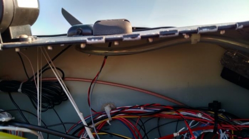

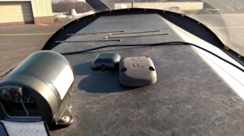

The WAAS GPS has 3 wires coming out the bottom of the device. So I drilled a hole in the glare shield, just behind the fuel tank (you don't want to get that drill hole location wrong!).
I twisted the red/black (power/ground) wires from the GPS. Twisting the wires definitely helps prefent unwanted interference, especially wiith the radios nearby.
The gray wire (GPS signal) was routed behind the panel to the port side, inside existing wire bundles, and down to the seat pan area where the echoUAT box is now mounted.
The black wire was run to my ground block. The red, power, wire will get attached to the panel switch, but I also need the echoUAT box's power to run there, too, so I need to get that run before I can tie it all to the switch.
About 1/2 hour of work, here.
WAAS GPS on the right (the GPS on the left is for the MGL stuff)

The antenna wire comes through just behind the fuel tank.

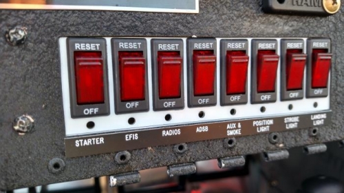

ADSB switch 4th from the left.
