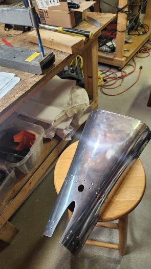

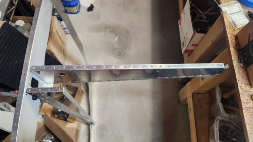

The first 2 photos are just more dimpling work.

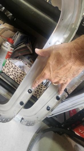

I plan to put my throttle and manual trim on the left side of the pilot. This means routing the trim cable other than as shown on the plans. So I went to look at Dave Setser's completed RV to see where the cable would run, so I can drill the holes and add the grommets NOW into the bulkheads. The two I'm pointing at in the 3rd photo are the locations in 2 of the 3 bulkheads.
Bottom aft skin dimpled
F-706 connected parts
Added holes for manual trim
