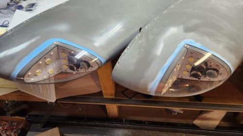

Finished sanding the 2nd wingtip light area, and removed the tape. Both wingtips are now complete.

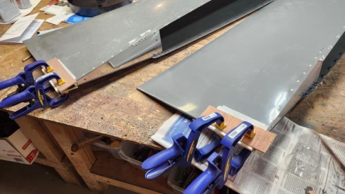

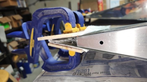

When trimming the trailing edges to match the ailerons, some of the trailing edge opened up. I used West Systems epoxy and fiberglass inside the trailing edges to "heal" them together. I tried just the epoxy a while back, but that didn't hold. So now I have the fiberglass in there.
Filler work complete.
Trailing edge joint fix
Fiberglass inside
Fiberglass inside
