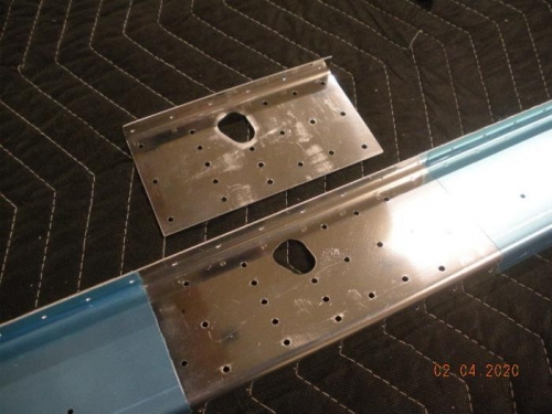

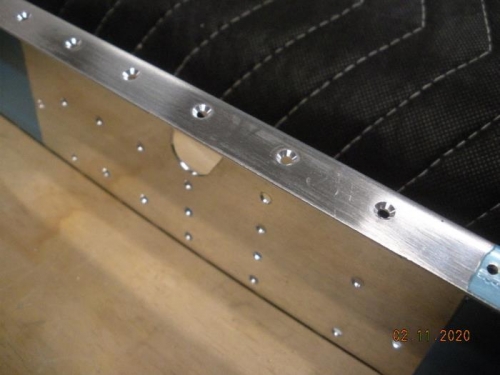

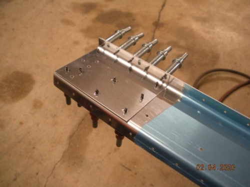

Install and match drill W-907D and E doubler plates on both spars. Mark and use die grinder to cut hole for aileron push tube. Countersink upper flange holes at doubler plates to accept upper skin dimples. The remander of the spar flange hole will be dimpled only.
Disassemble and deburr all holes.
Aileron pushtube hole cut
Countersink holes for upper skin dimples
