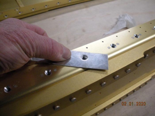

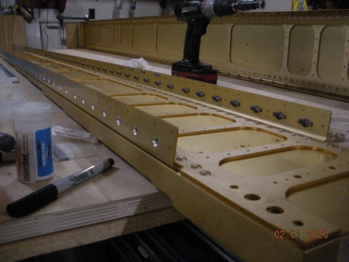

Brief Description:  Cutting countersinks for fuel tank mounting
Dimpled a piece of scrap aluminum the same thickness as the fuel tank skin and used it to gauge and set the depth of the countersinks for the fuel tank mounting screws.
Got both spar's done today.
CS for fuel tank screws
Gauging and setting depth with dimpled piece of scape aluminum.
