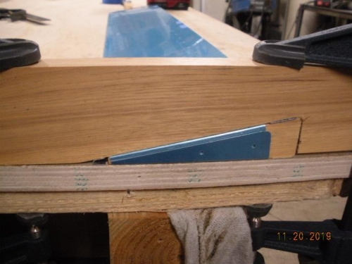

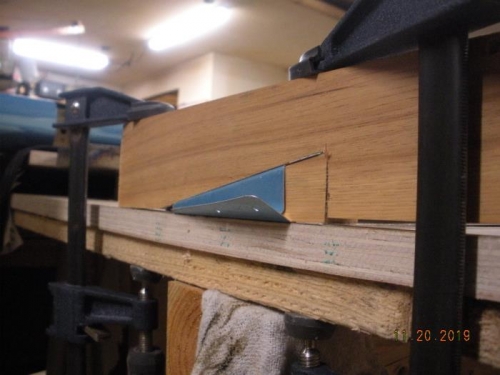

After completing the trailing edge bend so the the spar just slips in place, I made some clamping blocks for folding the end tabs. Worked very well and never slipped.

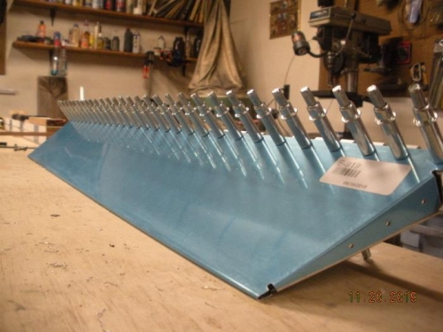

Drilled and cleacoed the spar and hinge into place. Then used a straight edge to check and adjust the trailing edge bend as per Sec. 5 of the plans.
