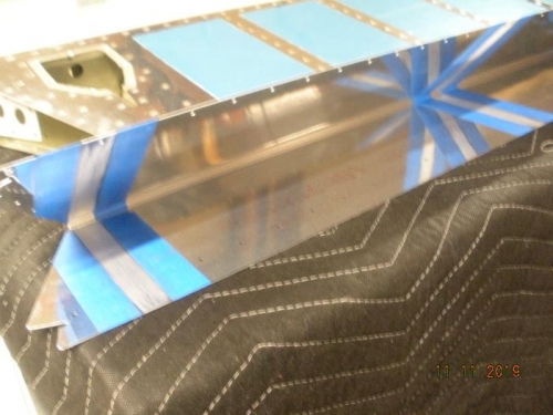

Located the position for the trim tab ribs and masked off the area. Sanded and cleaned in preparation to glue the ribs into place.

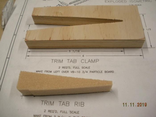

Used my CNC router to cut the trim tab clamps, and the foam ribs. Makes for very accurate parts production. Takes a little bit of programming time, but it's worth it.

masked and sanded
masked and sanded
CNC cut parts
CNC cut parts
