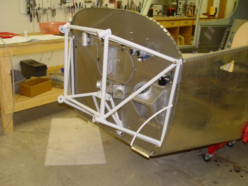

Drilled, deburred, and torqued. One hold didn't line up but by drilling and bolting other 5 bolts. Then I was able to drill remaining hole in line despite the fact that pilot hole was off center. Torqed them to 170 in lbs plus minus 10 to get bolt holes to align with castle nut
