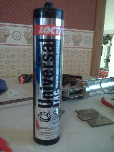

tested 3 differant acyrilic adhesives to use for the temorary tangs to help control the canopy position while the sika flex cures . The tangs will be removed at that point . So the following test was conducted to make sure this went smoothly and without damaging or leaving an absurd amount of work to remove the tangs or residue.
Loctie universal TAC remained plyable and peel able after 48 hrs . Bond is sufficent for this purpose and material was able to be realitivly easy to shear (bond) leaving no damage and residue cleaned easily.
PL - a bit stronger bond than the loctite cleaned well not damage but more strenght than is required.
3M 5200 - very strong bond - wouldnt risk it - hard to clean
Loctite will be used for the temporary tangs
