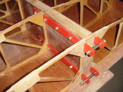

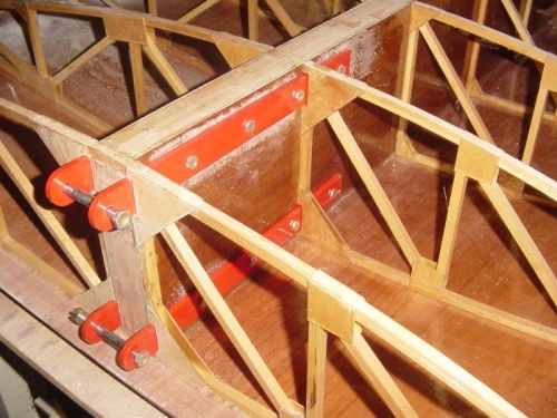

Lt panel Hardware - straps
Installed straps permenently -
Note for other builders - I believe the call out for the NAS1104/NAS6202 stap bolts were a dash 36. By the time I had all the weather proofing and powder coating on I managed to get one full thread out of the nut - I would purchase - 37 or 38 's.
Left panel straps permenant
