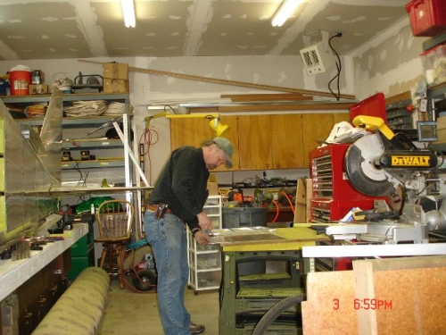

Worked on cargo door and left side skin. Drilled rivet holes for door skin and cargo door frame. De-burred, counter sunk back of cabin door and dimpled cabin skin along door edge and primed cargo door frames, door skin and cabin left side skin.

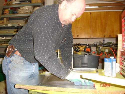

Cargo door de-burring
Green Pad to break shine

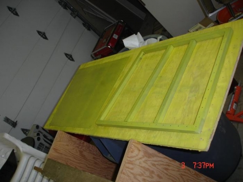

Cargo door primed
Cargo door primed
