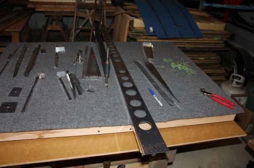

Rudder - Skin and Trailing Edge Attachment
Step 7 - Remove the skins and mark left and right
Step 8 - Put a slight bend in trailing edge of R-1001

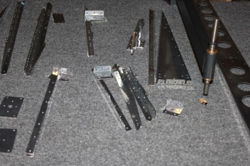

Step 9 - Remove R-607PP and R-608PP reinforcement plates and mark the sides which go against the spar web
Step 10 - Completely disassemble the rest of the rudder and deburr all holes and edges that have not yet been deburred
Step 11 - Dimple the holes of the skins and the corresponding holes in the flanges of the stiffeneres, spar and ribs.
