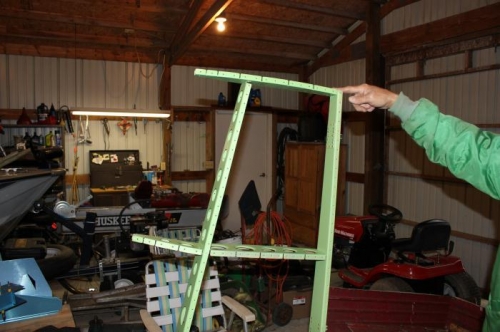

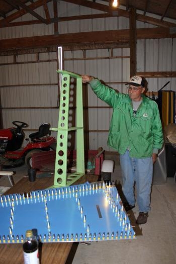

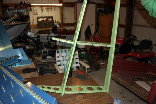

Step 1 - Attach the VS-1012 Top Rudder Hinge Brackets and the VS-1017 Hinge Doubler to the VS-1003 Rear Spar using AN470AD4-4 in 8 places. AN470AD4-5 in 8 places where the hinges meet.
Step 2 - Attach the VS-1015 Front Spar Doubler to the VS-1002 Front Spar using the rivets called out
Step 3 - Attach the parts shown Figure 3 using the rivets called out. Leave VS-1004 and VS-1005 clecoed to allow removed for acces to the interior.
