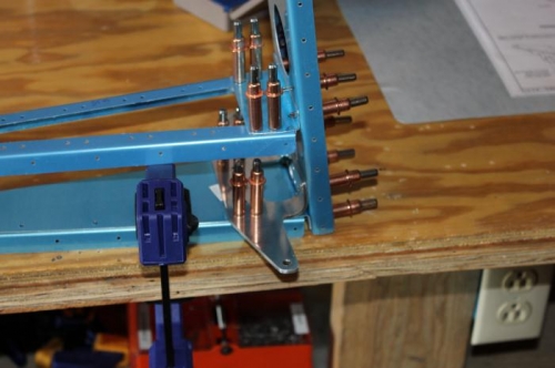

Attached R-1004A to R-1004B and final drilled with #30
Finish drilled and counter sunk holes on the rudder horn as indicated on the plans
Attached horn to bottom rib and match drilled six holes from horn to rib.

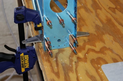

Attached striker plates and countersunk holes on stiker plate
