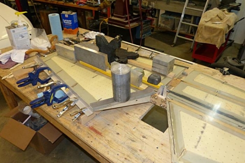

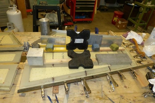

Brief Description:  Cleaned and bonded bottom skin to left stabilizer
Cleaned and bonded bottom skin to left stabilizer. Used same procedure to bond skin on left stabilizer as for the right yesterday. I found a good way keep the bottom skin aligned with the top skin while bonding. I aligned the bottom skin without any epoxy. I drilled small holes in the bottom and top skin flanges so I could put a small nail in the holes to keep alignment when I had epoxy applied. That worked good and saved some time.
