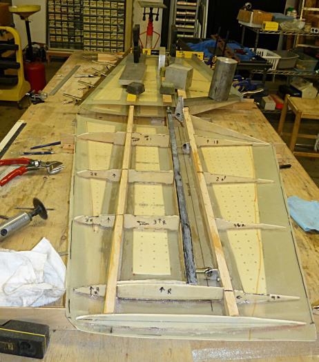

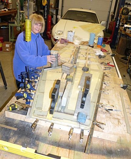

Brief Description: Bonding lower right bottom skin
Finished prep work and bonded the lower right bottom skin. Weighted the skin over the spars. Clamped the edges. Used metal angle and strip to ensure the edge stayed straight while the epoxy cured. We finished in about an hour which was at the limit of the working time for the epoxy. My wife helped and it would have impossible withouit her.
