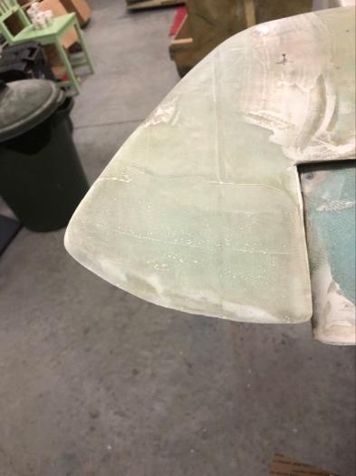

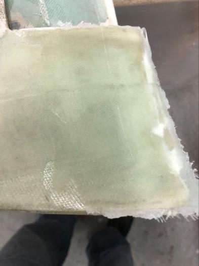

Removed the peel ply from the left fairing repair.
Trimmed and sanded the left fairing to shape.

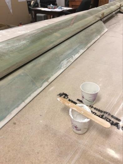

Sanded the top side of the canard, vacuumed the dust, and applied dry micro to any low spots on the top side.
