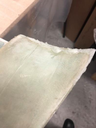

Continued sanding the bottom side of the canard, vacuumed the dust and then turned the canard top side up.

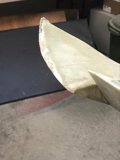

Sanded and vacuumed the area to be repaired on the top side of the left fairing.

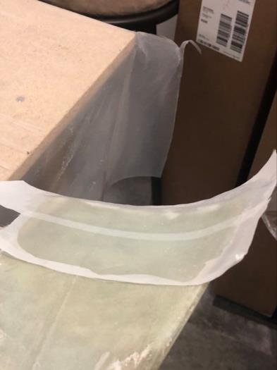

Applied flox to the edges of the top left fairing and applied a layer of BID cloth and covered it with peel ply.
