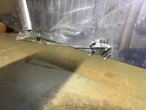

Rudder cable fairing temporarily attached with clecos.

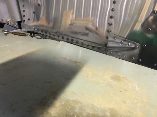

Completed right rudder fairling installation.
