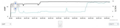

Electrical: Main bus, radio off: 12.5V, 4.1 A. Boost pump +5.6 A, 9.7 A total. Started ALT field off. Flipped on after restart: main bus 14.5 V, 5.5 A. Amps down to 4.8 after ~2 minutes. Turned on Nav, Strobe, Wig-Wag: total current about 14 A.

AMPS, Main Bus Voltage
