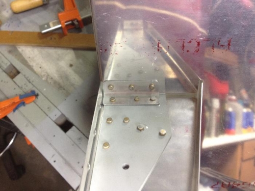

After dinner, smoothed the edges of the top fwd fuselage ribs and subpanels, then assembled and riveted the F-7108A center rib F-7108B angle, F-7108C plate, F-7109 doubler, and F-7105A center subpanel.
The primer on the F-7109 doubler and F-7108B angle was still soft, so I'll need to touch up dings and scrapes where they occured.
Center of the top fwd fuse

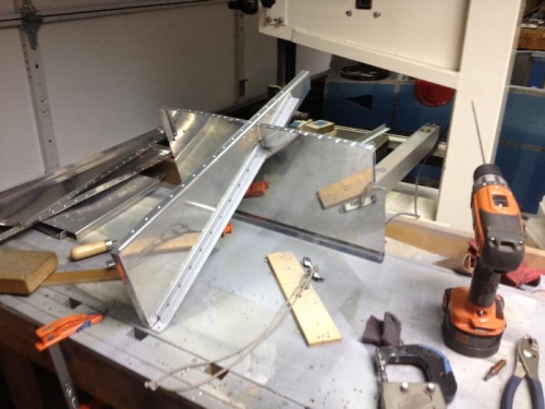

Rolled the assy 90 degrees cw

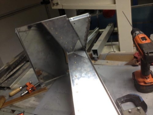

Turned the assy 180 degrees to see the F-7108C angle.
