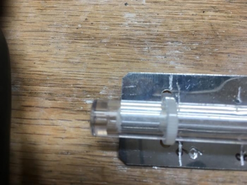

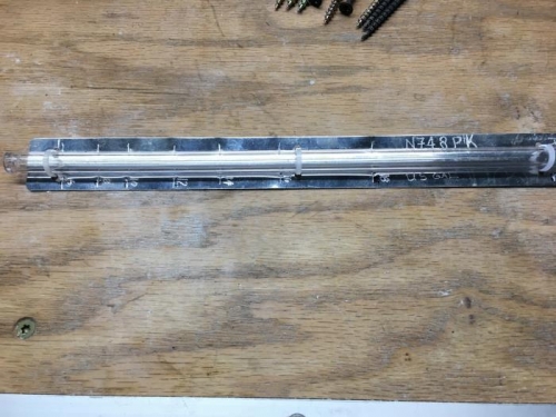

Used the engraver to permanently mark the fuel stick. (Images 2 and 3.)

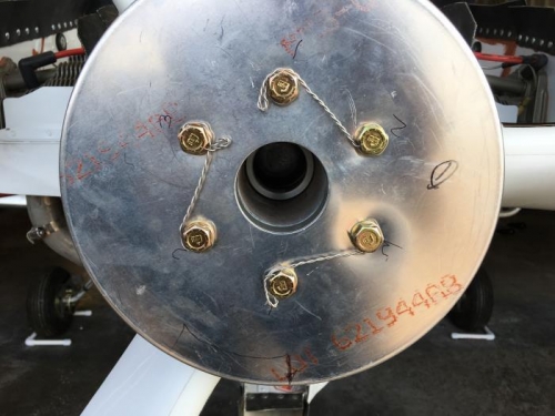

Untorqued the prop bolts and let prop "relax" for about 30 min, then retorqued to 37 ft-lb. Tracked blades with an Al pointer riveted to a piece of angle clamped to the side of a of a tall step ladder. Blades track close to +/- 1/16" (per AC 90-89A guidance) but may be somewhat more than that. Will bring a dial indicator to make better measurements. I safetied the bolts (image 1) anyway. Usefu to practice with the heavy safety wire even if I wind up removing it before first engine start.
Safetied prop bolts
Safetied prop bolts
Engraved the fuel stick scale
Marked the tube flush w/scale's edge
