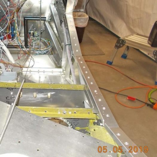

5/5/19
5.3 Hours
Drilled the six holes (three each) in the two right door strike plates. Deburred, bent and riveted.
5/6/19
2.4 Hours
Up drilled to #20 left door hinge to match factory drilled right door. Removed winrdshield. Installed foreward latch on right door with Locktite.
5/7/19
4.1 Hours

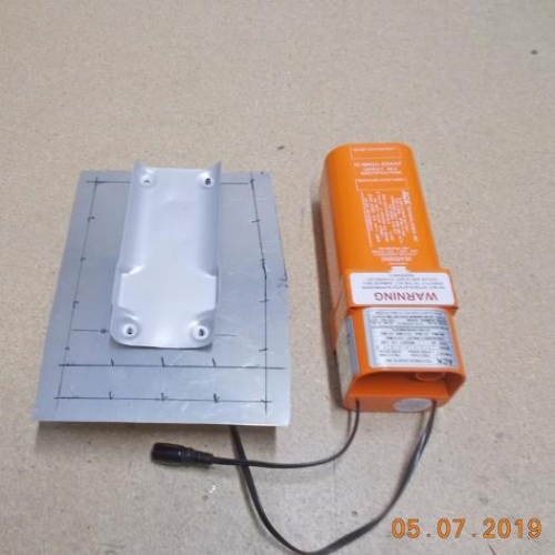

Riveted right door bubble with all rivets remaining (ordered 25 more from Zenith along 190 1/8" rivets for side and top windows.) Short, 5 ft antenna lead of ELT limites where it can go. Decided on location same area as flap motor except on left side. Made a backing plate for ELT mount,
Right strike plates
Right strike plates
ELT back plate in progress
